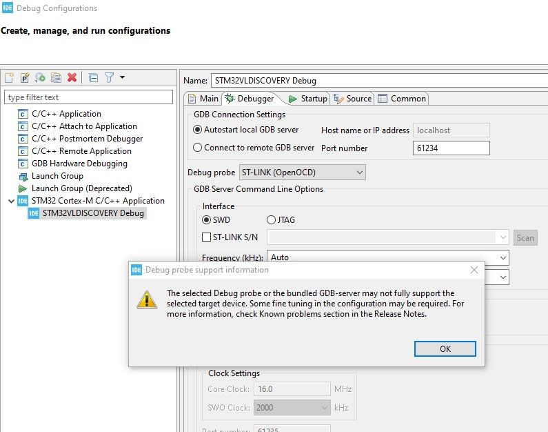

Here is the message from my 429I board
Error in final launch sequence:
Failed to execute MI command:
target remote localhost:61234
Error message from debugger back end:
Remote communication error. Target disconnected.: Success.
  • Remote communication error. Target disconnected.: Success.
The Success reported denotes me physically disconnecting the board
I have upgraded both the board firmware and theIDE to no avail

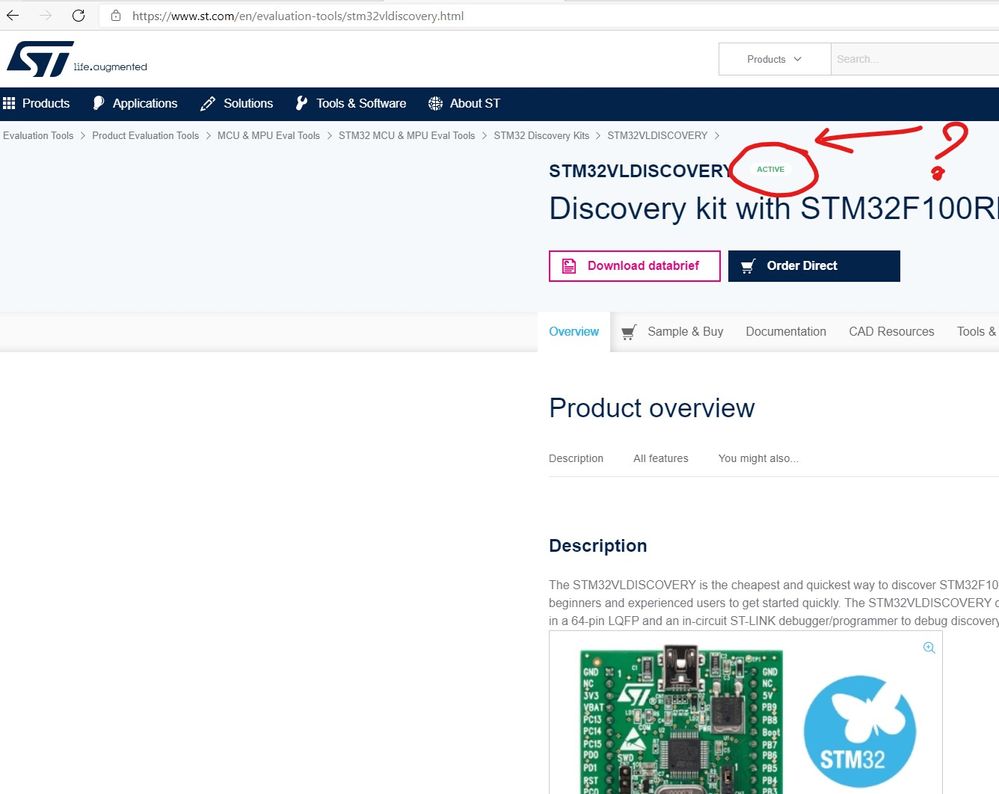

Cartu38 OpenDev
Lead III
At debug phase I'm getting myself proper info about support lack if debug based on STM32F100 VL-Discovery
But @Peter BENSCH​  my pain is such board is set as active ... :sleepy_face:
To respond to your points:
  • the support for STLINK (V1) has been removed many years ago
  • no need to switch to another toolchain, as there is a solution: just connect an external STLINK/V2 or V3, but please also note the next point
  • workaround: don't use the Board Selector while creating a project for the VLDISCOVERY but the MCU/MPU Selector, choose the STM32F100RB and select the necessary functions manually, i.e. RCC (clock), SYS (Serial Wire debug), GPIO (button, LEDs). Just tested: debugging and programming works fine.

Hi, @Cartu38 OpenDev​
for debugging using STM32CubeIDE please see my comment above.
For the availablity of the STM32VLDISCOVERY: active means Product is in volume production. And yes, debugging/programming is possible if you use an external debugger, e.g. an STLINK/V2-1 from a NUCLEO or other DISCOVERY.
Regards
/Peter
VDoro.1
I just tried this for the fun and it works: https://visserslatijn.wordpress.com/2019/01/20/upgrade-st-link-v1-to-v2/. However, the flashed firmware of the VLDISCOVERY programmer must be updated afterwards with the STM32CubeProgrammer to be fully usable.
As indicated by Peter above, the project must be created for STM32F100RB to avoid the "Debug is not supported" message. However, to get the .ioc file, just create an empty VLDISCOVERY project with the MCU/MPU Selector, then copy the .ioc file to the STM32F100RB project and rename the .ioc file.
