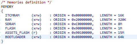

We are Planning to Use STM32F7508-DK board for our Application. As I go through Datasheet of it. It is mention that 64 KB for internal flash. But I am very sure that my application required more than 64 KB.
PFA first

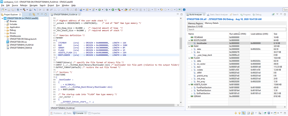

Question: As I can see my project is correct generated ?
Question: As I can see FLASH is 64 KB. why this is showing 1 Mb. Can anyone give me about all memory signifiance.
Question: I want to use external flash in case of my internal flash is full. So what exact change in my project ?
Question: What is command to generate binary for STM32F7508-DK board.
For example:
I have also same achive by below command which used for STM32F746G board.
arm-none-eabi-objcopy.exe -O binary --only-section=*Section "$ STM32F746G_DISCO.elf" TestExtFlash.bin;arm-none-eabi-objcopy.exe -O binary --remove-section=*Section "$ STM32F746G_DISCO.elf" Test.bin
NOTE:: I have added STM32F750N8HX_FLASH.ld in text format.
