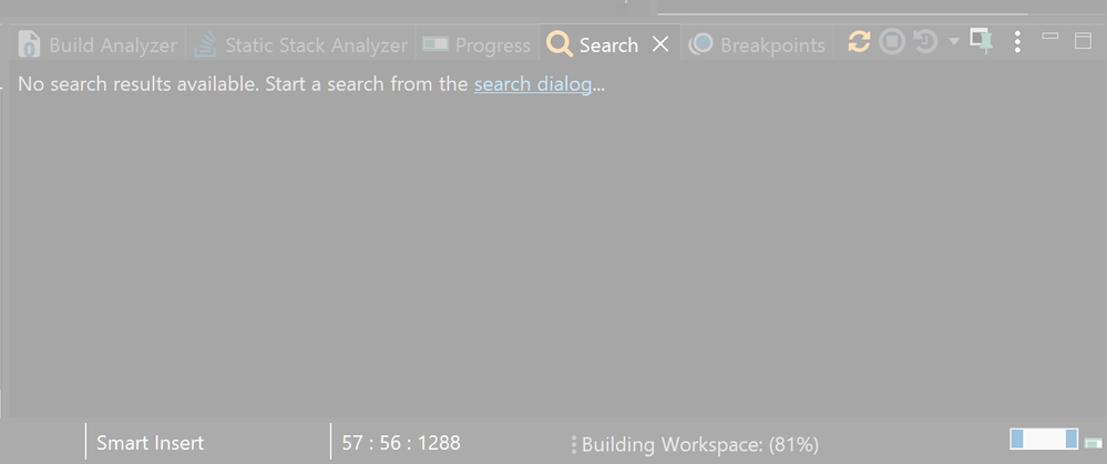

I select the "Clean" option to rebuild everything. As I expected, I get all CPU cores used for compiling the code and this is perfectly fine. However, it finishes as expected in less than a minute then the STM32CubeIDE just freezes doing nothing.
0693W00000UoShhQAF.pngThe app is totally unresponsive.

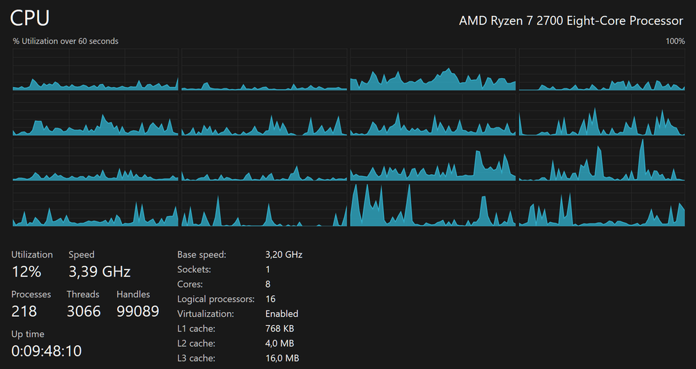

Here's what I have on Task Manager:
0693W00000UoShrQAF.pngThe cores still seem to be doing something, but it's just 5% usage by the IDE process.

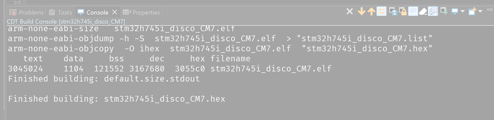

The app died, however, the huge lag is there even when it doesn't die. I usually see the message on the console it's done compiling, but then the mysterious super long process starts. It's nothing on the progress bar or the console, the app is just unresponsive.

Typical console output when it hangs:

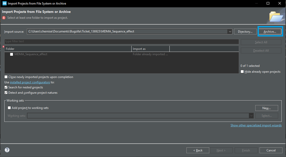

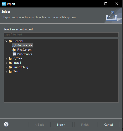

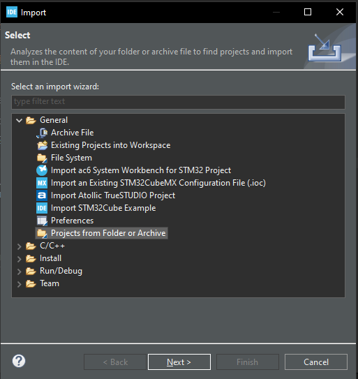

First could you please provide the workspace log for analysis.
Second, try to export the project you are working with as an archive.
Then import it in another workspace using the "Project from Folder or Archive" option.
Then tell me If the issue still exists.
