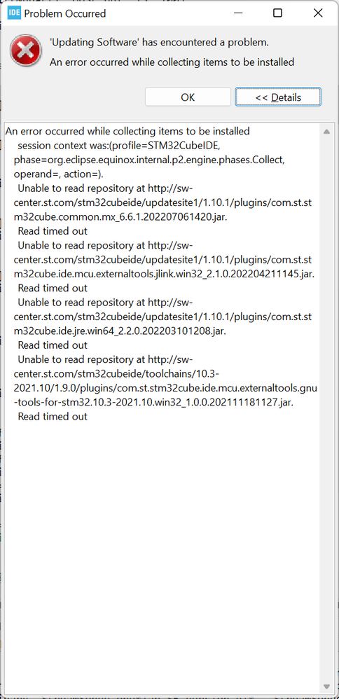

i cannot update the STM32IDE firmware. I only get this error after a long time of being stuck in the update process at 36%

Hello @Anton Kaisti​
If this behavior persists, try to check the network connection in the CUbeIDE. In case you are using a PROXY make sure that CubeIDE take the same configuration.
Don't hesitate to reply in case this proposition didn't respond to your exact need.

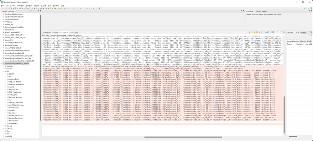

Hi, i now managed to update to the latest firmware, however now all projects have a massive amount of errors and i dont know what to do about them. Here an example:

Seems to be missing at least one include file.
Find first error.
Check where file is normally included in the build​, and that the file is present.
I would generally avoid updating a primary build environment, but understand ST pushes this and the instability that causes.​

Hi, the includes were correct. it was just that some variables were initialized 2 times and this did not cause any errors in the previous version (for some reason)
And i do agree with you that i should not update the version (for this exact reason) however we got a new sensor which had some drivers that were not available in the previous version. :grinning_face_with_sweat:
