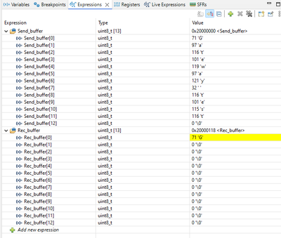

Hi all,
I have an STM32L071VBT6 and want to test the UART functionality. I configured UART4 RX and TX and physically connected them to do a loopback test.
I define 2 arrays to start with
/* USER CODE BEGIN PV */
uint8_t Send_buffer[] = "Gateway test";
uint8_t Rec_buffer[13];
/* USER CODE END PV */
I start by clearing the Rec_buffer array.
/* USER CODE BEGIN 2 */
  memset(Rec_buffer, 0, sizeof(Rec_buffer));
  /* USER CODE END 2 */
Then in my while loop I try to send and receive, but I always just receive the first character ('G' in this case in Rec_buffer[0])
 while (1)
    /* USER CODE END WHILE */
    /* USER CODE BEGIN 3 */
      // UART TRANSMIT/RECEIVE TEST CODE
      HAL_UART_Transmit(&huart4, Send_buffer, strlen((char*)Send_buffer), 100);
      HAL_UART_Receive(&huart4, Rec_buffer, strlen((char*)Send_buffer), 100);
      HAL_Delay(1000);
  /* USER CODE END 3 */
Anyone knows why I manage to receive only a single character each time?
Thanks!!
There is no automatic buffer. You need to be ready to receive when characters come in, not after.
That means you need to use a non-blocking receive call.
HAL_UART_Receive_IT or HAL_UART_Receive_DMA with appropriate data handling. Called before characters are transmitted.

Yes perfect thanks!
