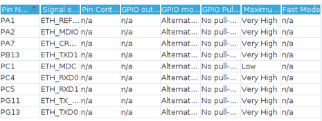

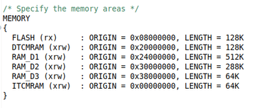

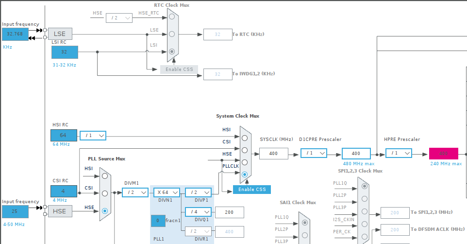

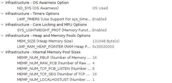

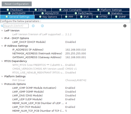

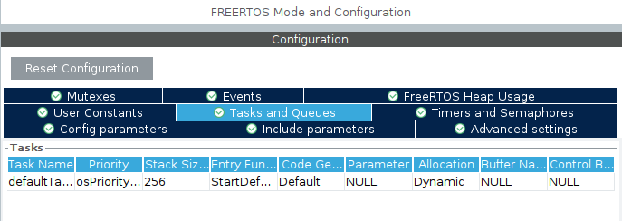

I am seeking assistance in troubleshooting an Ethernet communication issue between my laptop running Ubuntu 20.04 and the Nucleo-H743ZI2 board. As per the setup, the laptop functions as the client while the Nucleo board acts as the server.
Despite diligently following the guide provided : https://community.st.com/t5/stm32-mcus/how-to-create-project-for-stm32h7-with-ethernet-and-lwip-stack/ta-p/49308 , I have encountered difficulties in successfully completing a ping test between the devices. I have attached relevant configurations for your reference.
@Adam BERLINGER I would greatly appreciate any insights or suggestions to resolve this issue promptly?

Do you have other ethernet projects working on this board, to make sure that the hardware is good?
If not, then while waiting for more useful responses, try to build and run one of ready examples in the Cube package or from github. Do not change anything until some of these ready projects works as is.

Could you please provide guidance on whether it is feasible to employ the same configurations for the STM32-H743VIT6 board?
Is it a custom board, with custom PHY?
Of course, there are lots of projects with STM32H743 and Ethernet. This is the standard ethernet able to talk with Linux and everything else. But it needs a PHY. Without knowing details of your PHY, cannot help more.
