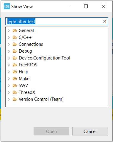

I'd like to add the TM Terminal plugin to STMCubeIDE 1.12.0.
I did add:
After installation and restart the plugin didn't show up within the Show View List Box:
Could somebody help me out it solving this problem?

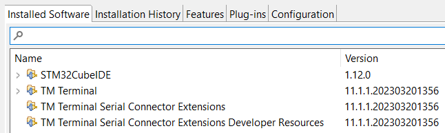

It seems that TM Terminal version 11.1.1 just does not work with STMCubeIDE.
I had TM Terminal 10.6 installed, and the IDE flagged an update to 11.1.1.
After updating there are error when trying to start the terminal plugin.
Re installing TM Terminal 10.6 fixed the problems.
After updating to STMCubeIDE 1.12.1 yesterday, I tried TM Terminal 11,1,1 again, but it still doesn't work.
First Uninstall TM Terminal by...
selecting 'Help'/'About STMCubeIDE'
click 'Installation Details'
Click on any TM Terminal entries then click 'Uninstall'
repeat this if necessary for each TM Terminal option listed
