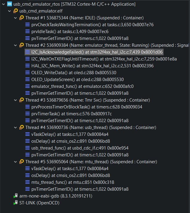

In STM32CubeIDE 1.0.2, after I added '-c "$_TARGETNAME configure -rtos FreeRTOS"' to 'OpenOCD Options', I could debug FreeRTOS's target with threading mode.
But, in STM32CubeIDE 1.1.0, even if I set same settings to 'OpenOCD Options', I could not debug with threading mode. In this version, openocd outputs 'Error: No symbols for FreeRTOS'.
Could you please check about this?

It is true, I get the error "Error allocating memory for xx thread" but debugger runs and "works". My problem was that I disabled the option of "set breakpoint at: main". And it is necessary to put the task method name
So, now I can debug the application and see the differnt threads, but I say "works", because the first time the debugger stop to all tasks, but the next iteration only stop at on task (the first that debugger entered).
I know that it is strange, but... Any idea?
Regards
Jordi
JBeca.1
ok, I think I found the "solution".
I had enabled the optimization option "Os" (for size), and I changed to "Og" (for debug), and debugger stop to all breakpoints always.
Thanks for the support!
Jordi

Needed to replace it with '-c "$_CHIPNAME.cm7 configure -rtos FreeRTOS" '.
The problem here was that the _TARGETNAME variable is not defined in the 'target/stm32h7x.cfg' OpenOCD script file!
Happy debugging :rocket:

`-c "$_CHIPNAME.cm7 configure -rtos FreeRTOS"`.
because `$_CHIPNAME.cm7` is used in config file (C:\STM32CubeIDE_1.5.0\STM32CubeIDE\plugins\com.st.stm32cube.ide.mcu.debug.openocd_1.5.0.202011091203\resources\openocd\st_scripts\targetstm32h7x.cfg).
Also, I needed to use the symbol `uxTopUsedPriority` in my code because in another case it was not compiled correctly.
In my case, I added `extern const int uxTopUsedPriority;` to my main.cpp and printed the value of `uxTopUsedPriority` (printf("uxTopUsedPriority = %d\r\n", uxTopUsedPriority)).

STM32CubeIDE version >= 1.5.0 has now the support for FreeRTOS™ thread-aware debugging.
See chapter 6 (RTOS-aware debugging) in STM32CubeIDE user guide UM2609

For FreeRTOS only RTOS-aware viewers have been added (Task list, Timers, Queues and Semaphore) - while no thread-aware debugging has been introduced (when you can simultaneously view stacks of all threads).
Please don't desinform people.
While the hack above works only with OpenOCD w STLink, it does not support STLink GDB Server yet.
