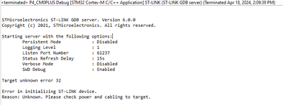

I am trying to debug both cores in STM32WL55CC chip. When trying debugging CM0+ i get error. I am using STM32CubeIDE ver 1.14.1 and also tried STM32CubeIDE ver 1.8 per a suggestion in older post, both don't work.
The followings are the configurations and error I am getting.

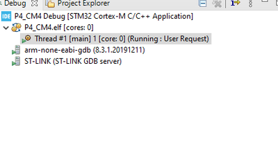

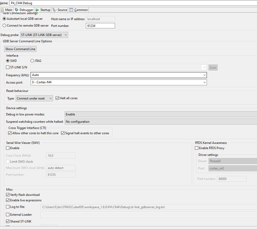

M4 running under debug:

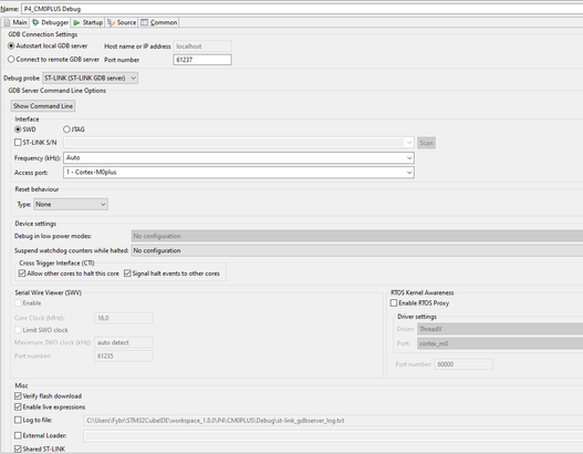

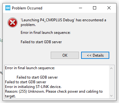

and now starting M0 under debug:
M4 code is indeed running but debugger seems preoccupied with it and won’t share the resource for M0 debugging.

I suggest that you take a look at the Application note AN5564. It highlights some of the points to bear in mind while debugging a device in the STM32WL Series. Knowing that I made a STM32 project using NUCLEO-WL55JC1, and I ran the debug session of the Cortex M4 and M0.

Sorry for my late replay. I've escalated your issue to the Concerned team for more investigation and correction if there is an error (under internal ticket number 182777).
