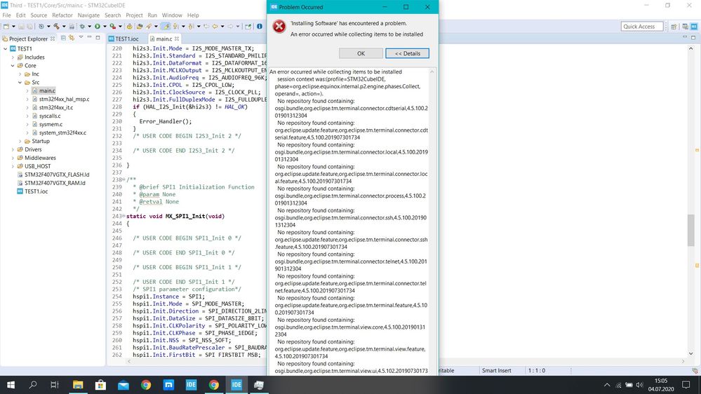

I want to use a terminal to check serial communication. I have tried to install a terminal to my CubeIDE software. I have followed this path:
Help --> Install a new software --> (I have looked for a "terminal" keyword. I have tried to install TM Terminal & TM Terminal Serial Connector Extensions)
But when I tried to install them I have encountered a message like that:
An error occurred while collecting items to be installed
session context was:(profile=STM32CubeIDE, phase=org.eclipse.equinox.internal.p2.engine.phases.Collect, operand=, action=).
No repository found containing: osgi.bundle,org.eclipse.tm.terminal.connector.cdtserial,4.5.100.201901312304
No repository found containing: org.eclipse.update.feature,org.eclipse.tm.terminal.connector.cdtserial.feature,4.5.100.201907301734
No repository found containing: osgi.bundle,org.eclipse.tm.terminal.connector.local,4.5.100.201901312304
No repository found containing: org.eclipse.update.feature,org.eclipse.tm.terminal.connector.local.feature,4.5.100.201907301734
No repository found containing: osgi.bundle,org.eclipse.tm.terminal.connector.process,4.5.100.201901312304
No repository found containing: osgi.bundle,org.eclipse.tm.terminal.connector.ssh,4.5.100.201901312304
No repository found containing: org.eclipse.update.feature,org.eclipse.tm.terminal.connector.ssh.feature,4.5.100.201907301734
No repository found containing: osgi.bundle,org.eclipse.tm.terminal.connector.telnet,4.5.100.201901312304
No repository found containing: org.eclipse.update.feature,org.eclipse.tm.terminal.connector.telnet.feature,4.5.100.201907301734
No repository found containing: org.eclipse.update.feature,org.eclipse.tm.terminal.feature,4.5.100.201907301734
No repository found containing: osgi.bundle,org.eclipse.tm.terminal.view.core,4.5.100.201901312304
No repository found containing: org.eclipse.update.feature,org.eclipse.tm.terminal.view.feature,4.5.100.201907301734
No repository found containing: osgi.bundle,org.eclipse.tm.terminal.view.ui,4.5.102.201907301733
How can I solve this problem?
Thanks for all answers already!

I solved this problem.
‎2020-07-10 8:38 AM
Hi @Mehmet Ümit Yiğit​ ,
Glad to know that you solved the problem you faced.
Could you please share with us what you did to get it resolved?
Thanks & Best Regards,
Amel
‎2020-07-10 9:20 AM
I have unchecked one of the details part. I don't remember it clearly. It was likely "Show only the latest version of available software". Then, it has run properly.
