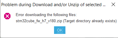

0693W000003OmOGQA0.png I am getting this error in stm32cubeide v14.1 while generating code can some one help me.

Not real sure. Maybe go into the directory, delete the file manually and retry. On windows, the directory is at:
C:\Users\%USERNAME%\STM32Cube\Repository

I have tried this but still got no result.

Do not only delete the .zip file but also the folder with the same base name.
