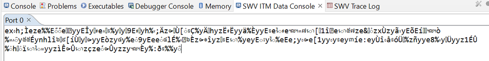

I want to use the SWD and ITM to print traces.

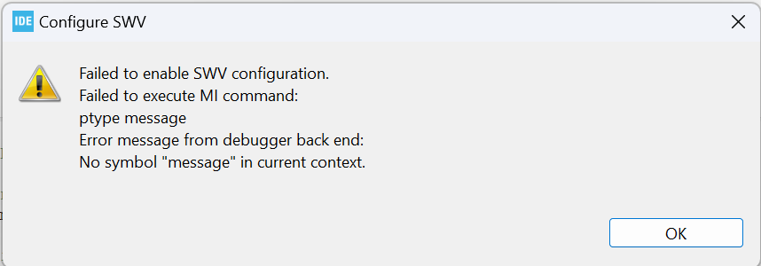

I followed the instructions of the STM32CubeIDE user manual but I got this error :
And I have this printed in the SWD Data Console :
I tried the solutions of the other topics related (even uninstalled stm32CubeIDE) but i've had the same issue.
My main is the following :

char* message = "hello";
while (1)
printf("%s", message); // Utilisation de printf pour envoyer le message

2024-06-18 1:59 AM
I try to put the write function outside my main but I still have the same issue, I also try to put the debug in "Serial Wire" and then in "Asynchronous trace" in the .ioc but the error is still here...
Does someone have an idea ?
