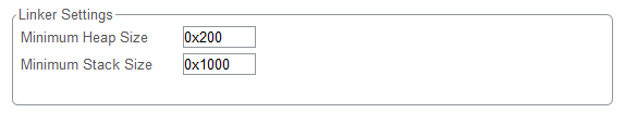

In the new project setup, the default minimum heap and minimum stack size are set to 0x200 and 0x400, but despite being in black they seem to be non-editable. For a large processor these numbers are far too small, especially the stack.
And yes I know I can edit the Linker file, as I have done, but really this parameter should be editable on the generation screen, and the default processor range specific. I would suggest stack of at least 0x1000 for a H7 or F7.

I can edit those fields and the correct linker script gets generated:
Is it non-editable for you in every project? I created one for a NUCLEO-H745ZI-Q and STM32H743I-EVAL and they both seem fine.
I did notice that I had to keep the mouse inside the text box in order to edit them, though. Perhaps that is what's causing it?
Ok – yes you need to keep the mouse inside but also turn off Windows screen magnification for those with poor eyesight. It works then and I can then turn magnification back on.
Thanks
