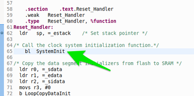

This linker script causes a hardfault immediately (on the second instruction executed), presumably because the stack pointer is bad:
The RAM size in the linker script is by default set to 160K, however, the size of SRAM bank 1 is actually 128K. Changing the map fixes the issue:

(the RAM1 size has been reduced to 128K)
However, this is discarding 32K of SRAM. Also note that if you look in the L452 examples in the ST github repo, it also only maps 128K RAM: https://github.com/STMicroelectronics/STM32CubeL4/blob/master/Projects/NUCLEO-L452RE/Examples/GPIO/GPIO_IOToggle/STM32CubeIDE/STM32L452RETX_FLASH.ld
_estack = 0x20020000; /* end of RAM */

I'm not entirely sure why the stack can't be placed in SRAM2 even though it is supposed to be mapped contiguously with SRAM1. This seems to be undocumented in the errata.

Hello @jeremyh
After checking internally, this is a known issue that has been tracked with this ticket 173165 that will be fixed asap.
THX
Souhaib
