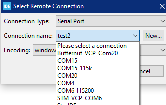

When I go to Debug => Open Console => Command Shell Console => Select Remote Connection, I have accumulated too many old connections. Any idea how to remove them? I am sure there must be a very simple method but it seems to have defeated me.

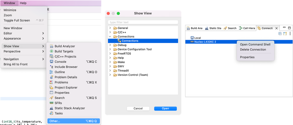

For all having the same issue and don't want to look in the .xml files ...
At least in version 1.12.0 running on macOS (12.6) there is a possibility to remove those connections within STM32CubeIDE.
Therefore open: Menu > Window > Show View > Other
In the new Window "Show View" open: Connections > Connections
In the opened tab "Connections" by right-clicking on the desired connection you can:
* Open Command Shell
* Delete Connection
* (Edit) Properties
Have a look at the Screenshots, too. (Might look different on windows)

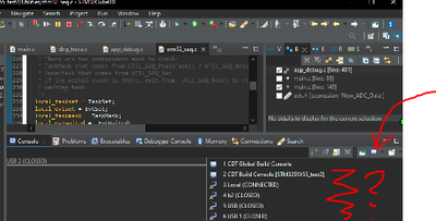

Even when deleted from the "Connections" Tab, all the old connections still remain (and accumulates) under the "Display Selected Console" tab.  I am using CubeIDE 1.18.1 and Windows
