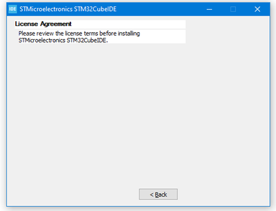

has anyone experienced similar issue when installing STM32CubeIDE?

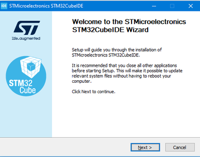

I am downloading STM32CubeIDE from ST official here , unzipping and double-clicking received exe file (in this particular case st-stm32cubeide_1.13.2_18220_20230914_1601_x86_64.exe)
I am starting installation with admin rights and see:
but it gets stuck here:
it simply disappears after few seconds and I can do nothing ;(
I have tried also with other version and the same result.
Basically I had previously STM32CubeIDE 1.8.0 and worked fine, but uninstalled to update to the newest version. And problems started.

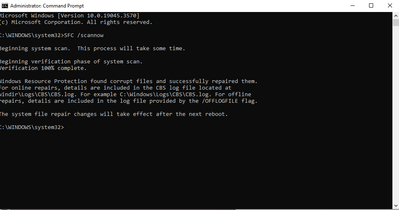

seems I have been able to fix this with running CMD with Admin rights and typing command
SFC /scannow
This is Windows tool to repair when some Windows functions do not work.
I have got summary after this
Seems good so far, I was able to install STMCubeIDE 1.14.0 and CubeMX 6.10.0
Hopefully it solves the issue finally.

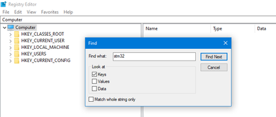

thanks for letting me know about 1.14.0 version however story remains the same, I can not install STM32CubeIDE.
I have double-checked registry looking for any stm32 keyword and this is as follows:
searching conditions
results:
This one can not be deleted:
Any further hints?
SFC /scannow
Thanks for your support!
surprise !  no new bug .
on my Laptop (on Win10/64 ) STMCubeIDE never could open an existing workspace a second time...so useless.
i tried IDE version 1.8. ... 1.13.1 , all same - can generate one project, but never open again, after close ide.
now i just tried running this SFC , as shown. after some minutes scanning : " no problems found" . ok.
BUT:   STMCubeIDE now starting ! in every workspace... unbelievable !!!
Thanks !!!
