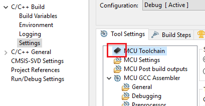

And regarding headless build: What does this chip.png file here actually refer to? Some image from the CubeMX config with a STM chip logo?
Managed Build system manifest file error: Could not load icon "icons/chip.png".

chip.png is this icon:
0693W000008vwf8QAA.pngLocated in plugins/com.st.stm32cube.ide.mcu.toolchain.arm-none_1.6.0.202102120935.jar.
