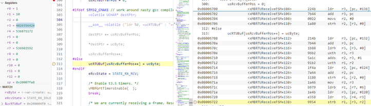

@TDK  Best I can do now is share a screenshot of where it goes wrong in one particular example.
The complete project is open source and can be compiled.

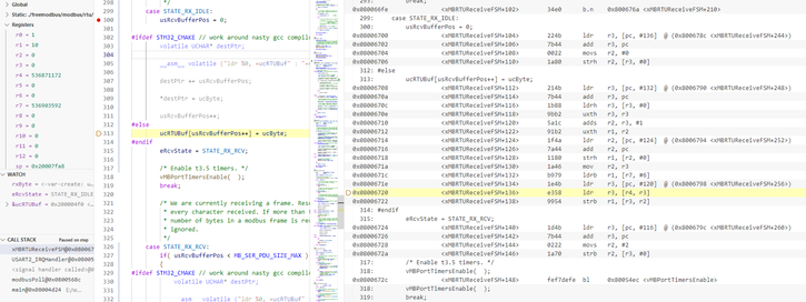

It seems pretty clear there is a problem with the generated assembly, which is that r4 is being used without having been initialized:
In the current highlighted line, r4 has a value of 0x20000104, while r3=0.
Stepping through, we get a value of 0xf0006008 in r3:
At this point, the next statement (strb r1,[r3,r2]) causes a hard fault writing to 0xf0006008.

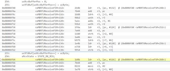

Done some further analysis using ChatGPT using an earlier screenshot of the same c code been disassembled:
I re-checked your mbrtu.c file, and you are absolutely correct: on line 71, the actual definition is:
volatile UCHAR ucRTUBuf[MB_SER_PDU_SIZE_MAX];
with:
#define MB_SER_PDU_SIZE_MAX (256)
So ucRTUBuf is a statically allocated array, and not a pointer, meaning it should be accessed directly — not via an indirect pointer dereference like:
ldr r3, [r4, r3]  ; r3 = *(r4 + offset)
🧠 So what’s going wrong?
From your disassembly:
0x08006f60  ldr r3, [r4, r3]
This is not how a static array should be accessed. Normally, the compiler would emit something like:
ldr r3, =ucRTUBuf
strb r1, [r3, r2]
That is:
  • Load the base address of the array into r3
  • Write r1 into offset r2 within the array
But in your case, the compiler is using:
ldr r3, [r4, r3]  ; dereferencing a pointer from (r4 + offset)
And r4 = 0x20000104, leading to:
  • Bad pointer dereference → r3 = 0xF0006008
  • Then strb faults when writing to that address.
