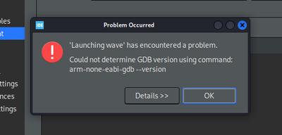

Initially I downloaded the Debian version of the IDE. Now I am using the generic Linux version. In both versions I could build the project, but in neither one of them could I run the program. I kept getting the error: Could not determine GDB version.
I tried to see where is the cross-compiler in use: Project -> Properties -> C/C++ Build -> Environment. Here the PATH variable is different from the system's PATH variable, having the following value:
/opt/st/stm32cubeide_1.17.0/plugins/com.st.stm32cube.ide.mcu.externaltools.gnu-tools-for-stm32.12.3.rel1.linux64_1.1.0.202410170702/tools/bin:/opt/st/stm32cubeide_1.17.0/plugins/com.st.stm32cube.ide.mcu.externaltools.make.linux64_2.2.0.202409170845/tools/bin:/home/daniello92/.local/bin:/usr/local/sbin:/usr/sbin:/sbin:/usr/local/bin:/usr/bin:/bin:/usr/local/games:/usr/games:/snap/bin:/home/daniello92/.dotnet/tools:/snap/bin
I supposed that the cross-compiler is taken from the PATH, so I went ahead and tested the GDB found in the PATH:
$ /opt/st/stm32cubeide_1.17.0/plugins/com.st.stm32cube.ide.mcu.externaltools.gnu-tools-for-stm32.12.3.rel1.linux64_1.1.0.202410170702/tools/bin/arm-none-eabi-gdb ~/STM32CubeIDE/ProjectX/Debug/wave.elf
/opt/st/stm32cubeide_1.17.0/plugins/com.st.stm32cube.ide.mcu.externaltools.gnu-tools-for-stm32.12.3.rel1.linux64_1.1.0.202410170702/tools/bin/arm-none-eabi-gdb: /lib/x86_64-linux-gnu/libncurses.so.5: version `NCURSES_5.3.20021019' not found (required by /opt/st/stm32cubeide_1.17.0/plugins/com.st.stm32cube.ide.mcu.externaltools.gnu-tools-for-stm32.12.3.rel1.linux64_1.1.0.202410170702/tools/bin/arm-none-eabi-gdb)
/opt/st/stm32cubeide_1.17.0/plugins/com.st.stm32cube.ide.mcu.externaltools.gnu-tools-for-stm32.12.3.rel1.linux64_1.1.0.202410170702/tools/bin/arm-none-eabi-gdb: /lib/x86_64-linux-gnu/libncurses.so.5: version `NCURSES_5.1.20000708' not found (required by /opt/st/stm32cubeide_1.17.0/plugins/com.st.stm32cube.ide.mcu.externaltools.gnu-tools-for-stm32.12.3.rel1.linux64_1.1.0.202410170702/tools/bin/arm-none-eabi-gdb)
/opt/st/stm32cubeide_1.17.0/plugins/com.st.stm32cube.ide.mcu.externaltools.gnu-tools-for-stm32.12.3.rel1.linux64_1.1.0.202410170702/tools/bin/arm-none-eabi-gdb: /lib/x86_64-linux-gnu/libncurses.so.5: version `NCURSES_5.6.20061217' not found (required by /opt/st/stm32cubeide_1.17.0/plugins/com.st.stm32cube.ide.mcu.externaltools.gnu-tools-for-stm32.12.3.rel1.linux64_1.1.0.202410170702/tools/bin/arm-none-eabi-gdb)
/opt/st/stm32cubeide_1.17.0/plugins/com.st.stm32cube.ide.mcu.externaltools.gnu-tools-for-stm32.12.3.rel1.linux64_1.1.0.202410170702/tools/bin/arm-none-eabi-gdb: /lib/x86_64-linux-gnu/libncurses.so.5: version `NCURSES_5.0.19991023' not found (required by /opt/st/stm32cubeide_1.17.0/plugins/com.st.stm32cube.ide.mcu.externaltools.gnu-tools-for-stm32.12.3.rel1.linux64_1.1.0.202410170702/tools/bin/arm-none-eabi-gdb)
/opt/st/stm32cubeide_1.17.0/plugins/com.st.stm32cube.ide.mcu.externaltools.gnu-tools-for-stm32.12.3.rel1.linux64_1.1.0.202410170702/tools/bin/arm-none-eabi-gdb: /lib/x86_64-linux-gnu/libtinfo.so.5: version `NCURSES_TINFO_5.0.19991023' not found (required by /opt/st/stm32cubeide_1.17.0/plugins/com.st.stm32cube.ide.mcu.externaltools.gnu-tools-for-stm32.12.3.rel1.linux64_1.1.0.202410170702/tools/bin/arm-none-eabi-gdb)
From the output I concluded, that I have a problem with libncurses package. On my Linux I have libncurses.so.6.5 and the lower versions point to this one:

I did not know how to resolve the issue, so I downloaded a newer version of the Arm GNU Toolchain. This worked in the terminal:
$ arm-none-eabi-gdb ~/STM32CubeIDE/ProjectX/Debug/wave.elf
GNU gdb (GNU Arm Embedded Toolchain 10.3-2021.10) 10.2.90.20210621-git
Copyright (C) 2021 Free Software Foundation, Inc.
License GPLv3+: GNU GPL version 3 or later <http://gnu.org/licenses/gpl.html>
This is free software: you are free to change and redistribute it.
There is NO WARRANTY, to the extent permitted by law.
Type "show copying" and "show warranty" for details.
This GDB was configured as "--host=x86_64-linux-gnu --target=arm-none-eabi".
Type "show configuration" for configuration details.
For bug reporting instructions, please see:
<https://www.gnu.org/software/gdb/bugs/>.
Find the GDB manual and other documentation resources online at:
    <http://www.gnu.org/software/gdb/documentation/>.
For help, type "help".
Type "apropos word" to search for commands related to "word"...
Reading symbols from ~/STM32CubeIDE/ProjectX/Debug/wave.elf...
(gdb)
I tried 2 methods to make the IDE use this version.
First:
$ cd /opt/st/stm32cubeide_1.17.0/plugins/com.st.stm32cube.ide.mcu.externaltools.gnu-tools-for-stm32.12.3.rel1.linux64_1.1.0.202410170702/tools/bin/
$ mv arm-none-eabi-gdb arm-none-eabi-gdb_bck
$ mv arm-none-eabi-gcc arm-none-eabi-gcc_bck
$ mv arm-none-eabi-g++ arm-none-eabi-g++_bck
$ ln -s /usr/bin/arm-none-eabi-g++ .
$ ln -s /usr/bin/arm-none-eabi-gcc .
$ ln -s /usr/bin/arm-none-eabi-gdb .
Second:
Changed the order in the IDE PATH variable, making /usr/bin the first.
Neither one of these solutions worked. Do you have any idea why? What could I do to flash my STM board?

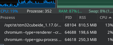

Then try a simple test, made empty program for a H7S3...and bad surprise:
- compiler starts with "make j8 all " , but 3 minutes happens nothing !!! then 5 secs or so...ready. no errors.
Very strange....

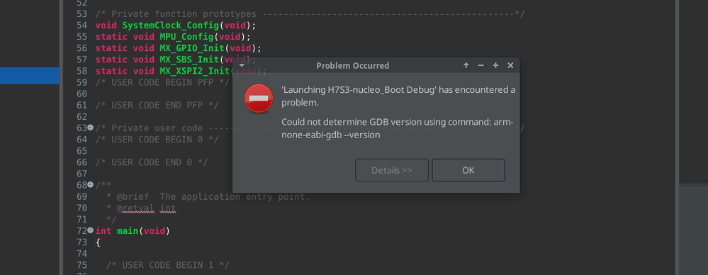

Then try debug: again , 3 minutes happens nothing (!), then:
Then tried importing a working F303 program, made on same PC, but with (old) MX Linux and IDE 1.13.1, but exactly same result ...
In these 3 minutes it makes 100% cpu load on one core (of 8, so about 13% ), so some heavy action...for nothing.
Maybe it cannot access something, but without any error message - how to find out, whats wrong?
I had the same issue today and found out, that the IDE needs the package libncurses5, but on newer distros there is only libncurses6, so you need to install this package manually:
wget https://archive.ubuntu.com/ubuntu/pool/universe/n/ncurses/libtinfo5_6.3-2_amd64.deb && sudo dpkg -i libtinfo5_6.3-2_amd64.deb && rm -f libtinfo5_6.3-2_amd64.deb
wget https://archive.ubuntu.com/ubuntu/pool/universe/n/ncurses/libncurses5_6.3-2_amd64.deb && sudo dpkg -i libncurses5_6.3-2_amd64.deb && rm -f libncurses5_6.3-2_amd64.deb
Ok, after trying and searching... i got the IDE 1.17.0  running, on new/actual Linux siduction (debian system).
Needed to open a shell and set :
> ulimit -n -H 4096
> /opt/st/stm32cubeide_1.17.0/stm32cubeide &
Then compiler (make all) starting without great delay. (on small program : 3m55s -> 240ms ).
And to get debug running :
- didnt want to get the system to an unknown/unsafe state, by importing and manual forced install of libncurses5 , about 14 year outdated lib; same for outdated old libtinfo5 .
- so i tried install new dbg and replace the old:
in shell:
> sudo -i
> apt install gdb-multiarch
> cd /opt/st/stm32cubeide_1.17.0/plugins/com.st.stm32cube.ide.mcu.externaltools.gnu-tools-for-stm32.12.3.rel1.linux64_1.1.0.202410170702/tools/bin # or wherever you installation is
> mv arm-none-eabi-gdb arm-none-eabi-gdb.bak
> ln -s /usr/bin/gdb-multiarch arm-none-eabi-gdb
Now its starting gdb-multiarch ... as gdb:
