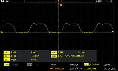

PWM output on PA8 (TIM1_CH1) does not reach 0V — waveform distorted

  Start_XCLK(); //PWM開始
  I2C_Scan(); //I2C接続確認
  Read_MT9M001_ChipID(); //チップIDを読み取る

  htim1.Instance = TIM1;
  htim1.Init.Prescaler = 0;
  htim1.Init.CounterMode = TIM_COUNTERMODE_UP;
  htim1.Init.Period = 7;
  htim1.Init.ClockDivision = TIM_CLOCKDIVISION_DIV1;
  htim1.Init.RepetitionCounter = 0;
  htim1.Init.AutoReloadPreload = TIM_AUTORELOAD_PRELOAD_DISABLE;

  sConfigOC.OCMode = TIM_OCMODE_PWM1;
  sConfigOC.Pulse = 4;

  __HAL_TIM_MOE_ENABLE(&htim1);  // ★ Advanced-timerの出力許可

I’m using the STM32F429I-Discovery board.
I’m trying to generate an external clock (XCLK, about 24 MHz) for a camera module from TIM1 CH1 (PA8), but the PWM waveform doesn’t look correct on the oscilloscope.
A square wave appears, but the voltage never drops to 0 V and the waveform is distorted.
Here are my settings and environment:
  • Board: STM32F429I-Discovery
  • IDE: STM32CubeIDE 1.19.0
  • Clock config: PLL = HSE (8 MHz) × 360 / 2 = 180 MHz
  • TIM1: Prescaler = 0, Period = 7 (≈ 22.5 MHz output)
  • PWM mode: PWM1, Duty = 50 %
  • GPIO: PA8 (AF1, Push-Pull, Very High Speed)
  • __HAL_TIM_MOE_ENABLE(&htim1); is called
  • Observation: square wave visible, but it does not go down to 0 V
Could anyone suggest possible causes or points to check?
I suspect a GPIO AF conflict or initialization order issue, but I’m not sure.
Thank you in advance for your help.
12 REPLIES 12
It's excess capacitance. Keep checking. ESD damage would tend to skew the signal to 0 V or 3.3 V, not midline. Missing something. Verify the pin can output 0 V and 3.3 V cleanly when set to output mode.
PB0 (TIM3_CH3) worked. I was able to output a clean PWM signal from that pin.
Thank you for the suggestion.
Sorry for not replying earlier as I got busy with other projects.
Glad to hear that issue has been resolved.
