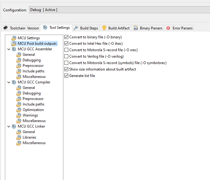

I'm using the IDE project properties "MCU Post build outputs" section to enable bin file generation.
The default behavior though is filling non used gaps in output bin with 0x00, Is it possible to override the "arm-none-eabi-objcopy" with "--gap-fill=0xff" to change default behavior? I couldn't find any place to override this in project properties inside the IDE itself... only run it via post build steps manually and disable the "output bin generation" checkbox above.
Thank you.

I have the same question. I've even set the post-build step command to:
arm-none-eabi-objcopy --verbose -S -O binary --gap-fill 0xFF --pad-to 0x20000 "project.elf" "project.bin"
Set in the STM32CubeIDE project settings as so:
But my binary is not padded to 128 KB even though it is produced. The only output I receive, despite the --verbose setting, is:
copy from `project.elf' [elf32-littlearm] to `project.bin' [binary]
How can I pad my binary out to the full 128 KB flash size using STM32CubeIDE?
