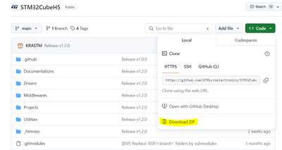

If you have Downloaded STM32CubeH5 from the GitHub as a .Zip File:
That may cause Some problems. You should download it using this Git command:
git clone --recursive https://github.com/STMicroelectronics/STM32CubeH5.git
 Or as a .Zip from our Website link.
Best Regards.
