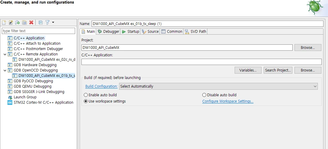

In order to obtain CIR data, firmware is required, so the sample is executed using STM32cubeide v17.0, but there is a problem with the debug.
First, that can't find the ST-LINK/V2 serial number.
Second, when i click the debug​ button, see error message "Won't launch debug session since we failed to locate the binary."
0693W00000FCZaYQAX.pngThird, my debug configuration setting uncertain.

And created the debug configuration about "STM32 Cortex-M C/C++ aplication", By the way, there were two problems.
First. Main tap ​have some issue the "Program not specified" error.
0693W00000FCbBZQA1.pngSecond. how can i change the open ocd? Now my setting is "ST-LINK (ST-LINK GDB server)" when i change the "ST-LINK (OpenOCD)" there's no setting.

How did you create your project in cubeIde? For some reason your project toolchain is not configured properly. Maybe project was created or imported from older Ide version and something is broken now. In this case installing older Ide version would be fastest way to make things work. Problem with debug in current version may be investigated later ​

I may have found a solution. I was working on my new gesture recognition module project for Arduino and other I2C capable boards, and my STM32H7 bootloader project refused to debug after I copied some files. I am not sure what exactly caused this, but what was missing is "C/C++ Application:" path to my "Debug/h7-loader-25mhz-pa9pa10.elf".
On your screenshots "C/C++ Application:" is blank too. Try to do this to fix it:
1 - manually enter path to ELF file in  "C/C++ Application:"
or
2 - go to "Common tab", check "display in favorites menu" for "Run". Close all dialogs. After pressing debug hotkey/menu, STM32Cube Ide pop-ups message and asks which .ELF file to use.
I hope this solves debug button grayed out / error problem.
