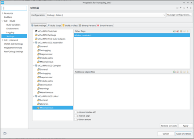

I get a multiple definition error for every variable declared inside a .h file after updating from CubeIDe 1.8.0 to 1.9.0. The previous CubeMX version was 6.3.0 and now it is 6.5.0. Before updating there would be no errors while building the code. The .h file has the header guards generated by the IDE. Is there any way to fix this?

Works for me. Thanks !
