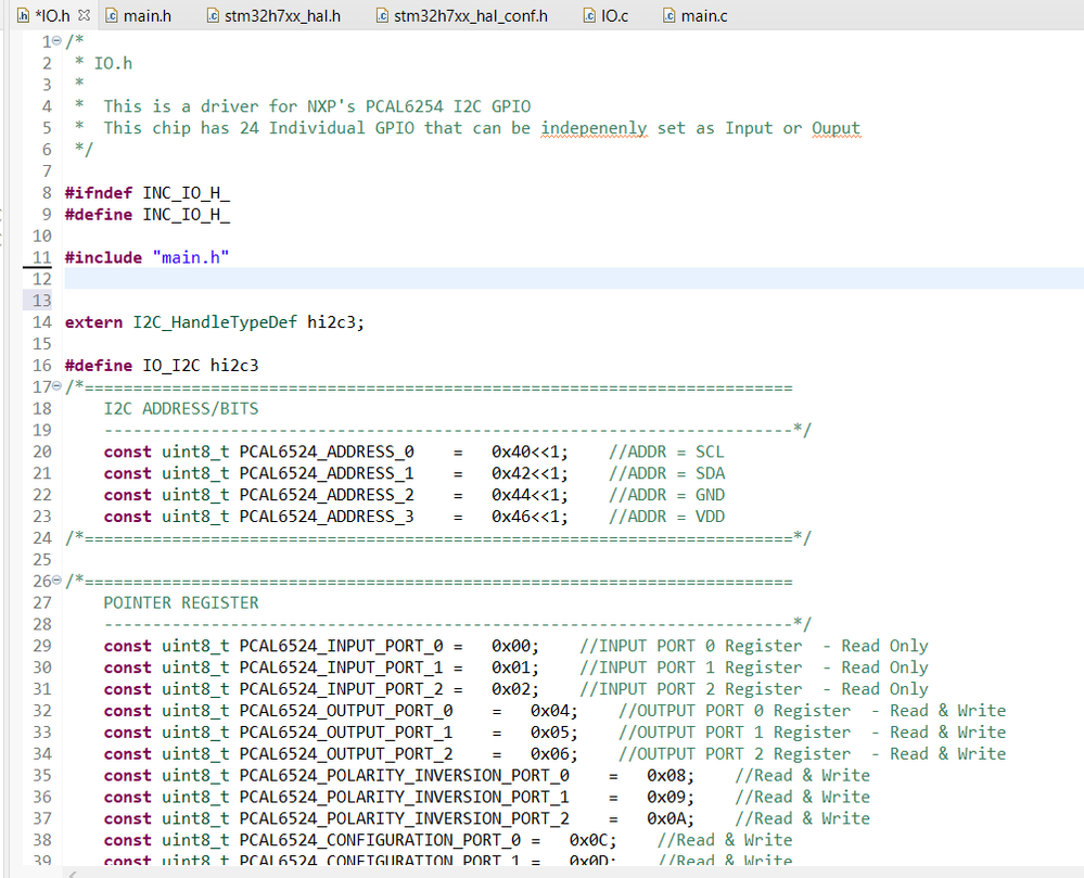

I am creating the header and source file according to the IC. Two Ic I interface and created its header file particular ,but when I tried to add header file in second source file I getting this and errors. I am unable to understand why its errors are come There are 2 core ,core M4 and M7.In both core the IO.h are defined when I tried to add this file to any source files it through errors.

No, what you're probably doing is defining variable(s) in an include file, which is a no-no.
The include file should have prototypes and externs, and the functions and variables defined ONCE in a source file.
Include files should not have code in them.
IO.c and IO.h need to be worked on.

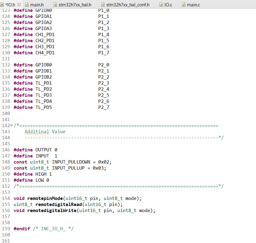

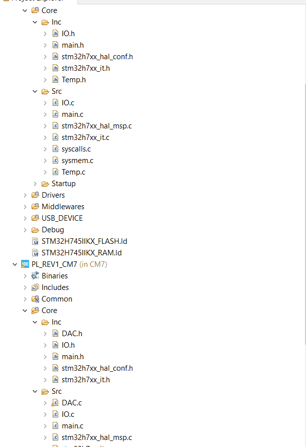

When I try to add IO.h in IO.c its working fime but when I try to add this file in main.c or temp.c it throw errors.I am sharing the the snap of my files, i am unable to understand why its erroe comes.0693W00000KdUKOQA3.png0693W00000KdUKEQA3.png0693W00000KdUK4QAN.png
>> i am unable to understand why its error
It SPECIFICALLY tells you it's those variables you're defining as const.
Put those in IO.C, or use #define's or enum's
Thank you the error gets solve​
