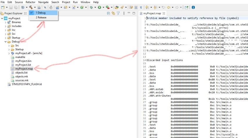

Hi. Is there a file, generated by STM32CUBEIDE, that report the absolute address of global variables of application? Thanks for answers.

Not using CubeIDE, but the GNU/GCC .MAP file should list globals and addresses in RAM
Cartu38 OpenDev
Lead III
Building a build configuration 'X' is creating a 'X' folder within your project repository. Such exposes all build artifacts including map file
