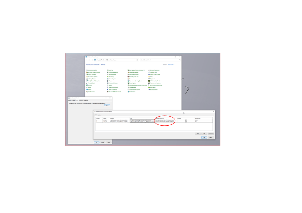

Update - Solution: in case it helps:
I found some older threads suggesting that turning off direct32 in Java made a difference. I didn't work that out for myself but I'm posting this because I couldn't find any simple documentation showing how to implement it.
I did it as follows:
  1. Open the Java control panel (run control.exe from the start menu if you can't find it).
  2. Click on the Java tab.
  3. Click on the View... button to manage settings for Java applications.
  4. In the runtime parameters, enter-Dsun.java2d.d3d=false STM32CubeMX.exe in the Runtime parameters.
0693W000007CozpQAC.png I did it for both lines. I assumed it should only be required for 64-bit but I couldn't tell which was being used.
Result: Changing a pin definition now takes about 1.5 seconds instead of > 30 seconds.
(If Java gets updated, it may be necessary to edit this again - I have no idea).

I've got a try to -Dsun.java2d.d3d=false ... helpful a on my side if Win10 and quite responsive hardware setup at least.
Right place to add such is stm32cubeide.ini file.
Any drawback of ? ... need to play a bit more with I guess ...

@Cartu38 OpenDev​ Thanks - I added the line '-Dsun.java2d.3d3=false' at the end of stm32cubeide.ini. It seems to work although sometimes it starts going really slowly again and I have to quite STM32cubeIDE and restart it.
