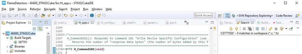

2019-07-13 10:15 PM
This is how my toolbar looks.
I can only build using the right-click on my project and choosing Build-all.
I think that the makefile or the build targets haven't been setup correctly.
I'd appreciate any ideas...

I believe I just answered you privately instead but I'll post the same here in case anyone is facing the same issue:
"Make sure you are in the C/C++ Perspective (top right) and if you still don't see it, try to go to "Window -> Perspective -> Reset perspective...". If that doesn't work I suspect something might have gone wrong with the installation, maybe?
As to the right click of the project, right under "Import" and "Export" should be "Build Project", which serves the same purpose as the "hammer" button does."
And to add to that, right under the "Build Project" is the "Clean Project".
2019-07-16 1:22 AM
Resetting the perspective worked!
Thanks!

2019-07-16 1:47 AM
I changed the Builder to Internal (it was external) - uses the same gcc compiler - and now the "hammer" builds the project!
