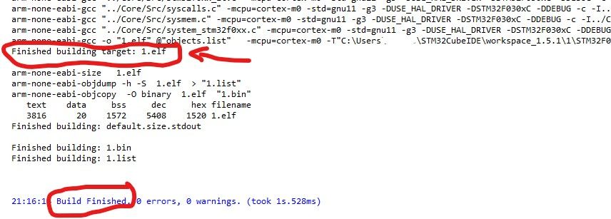

Cartu38 OpenDev
Lead III
.elf file generation and location is promoted as part of build console log
0693W000007EBkBQAW.jpgFirst build your project. Wait for completion then create a brand new debug configuration ... STM32CubeIDE should found .elf file by itself

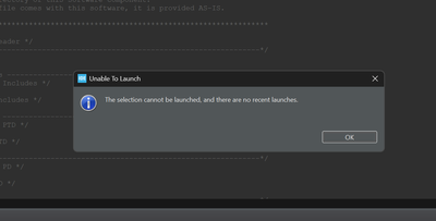

Hello! But what to do if binaries are not generated? I tried manually switch to utf8, but it has no effect
I also keep receiving this messege from CubeIDE like there is still no applicable launches for debugger and ,,run'' section
There should be some reason why the binary (elf) wasn't generated. Please carefully check the build log.
Clean the project, refresh, rebuild.
Without the binary, you cannot debug, of course.
