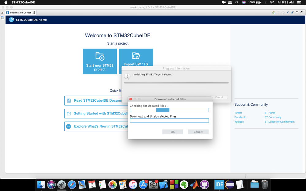

I've installed the STM32IDE on my Mac and clicked on Open new project. The IDE is now showing 'Checking for updated files' for 2 hours on a good internet connection. What should I do?

Hello, maybe you have an issue with the proxy.
Check on STM32IDE settings if proxy parameter are aligned with your policy network.
Regards

Thanks for the quick response. Could you please guide me with the steps to align the proxy parameters?
Please, are you on a public, private or business ... network?

Private network
In STM32CubeIDE go in "Windows" menu--> Preferences--> general--> Network Connections.
If you have specific settings for your network, it's the place to be ;) .
If you are not able to connect to the net, you can disable the automatic update in "Windows" menu--> Preferences-->"Install/Update" menu!

Thanks a lot!​
