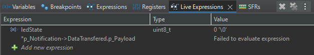

i want to monitor the following statement (the value of p_Payload[]) during debugging process in the Live Expression Window of CubeIDE:
if(p_Notification->DataTransfered.p_Payload[0] == 0x02)
I added the following statement to the Live Expression Window
and tried a few other variations, but without succes.
Can somebody help?

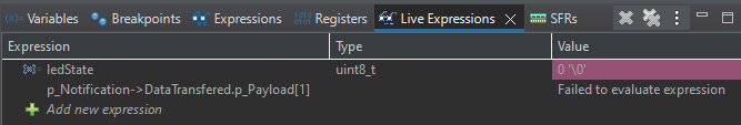

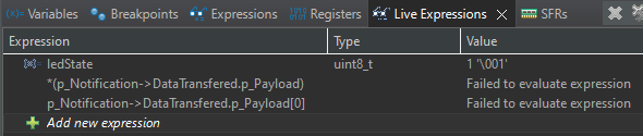

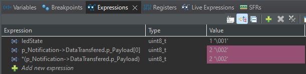

Hello @Ghofrane GSOURI ,
thank's for your reply. That works in "Expression Window"
but not in "Live Expression Window" as you can see here:

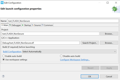

Could you please verify that the Live Expressions is enabled in your configuration.
To do that please follow those steps:
1- right-clicking on your project in the Project Explorer and selecting Debug as-->1 STM32 C/C++ application
Go to Debugger and make sure that the live expression option is tick then press OK

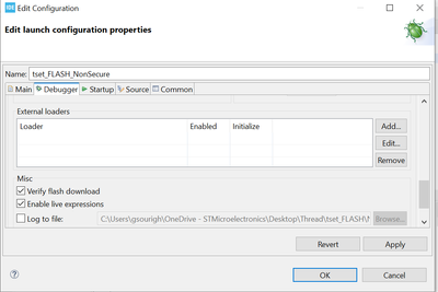

‎2024-11-14 5:38 AM
yes, live expression is activated.
And for example, the variable "ledState" which is defined as "extern uint8_t ledState = 0;" is working in the Live Expressions window:
‎2024-11-14 6:26 AM
Hello @ledi7
Live Expressions can only evaluate variables that are currently in scope. p_Notification
is a local variable of a function that has exited
void OTA_Notification(OTA_NotificationEvt_t *p_Notification);
its memory may no longer be valid, leading to evaluation failures. Ensure you are trying to access the variable while still within the function where it is defined.
or consider using global variables for debugging purposes, as they tend to be more stable in Live Expressions
