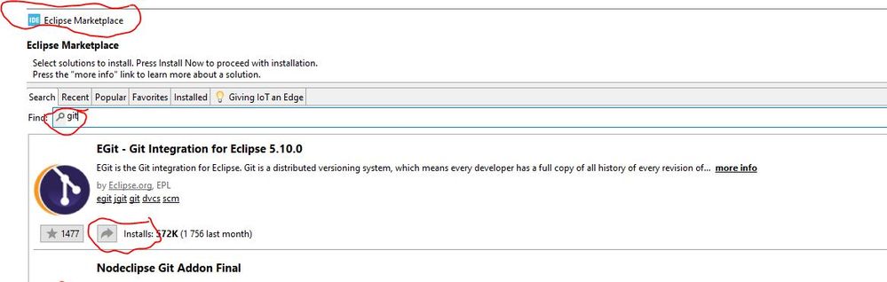

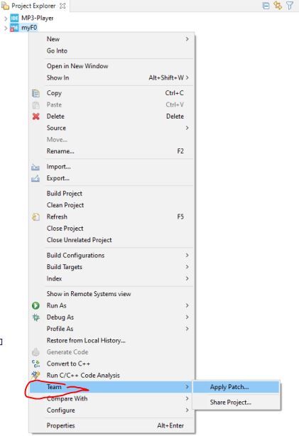

Both proposal here.
Either rely on a terminal and play with common git batch commands (git amend <patch file>).
Or add integrated git support to STM32CubeIDE relying on Eclipse market place (Help>Eclipse Market Place)
Some new project contextual menu so called "Team" is then available to you allowing full GIT management

Both proposal here.
AFido.1
Thank you very much Cartu38 OpenDev. It works perfectly!
