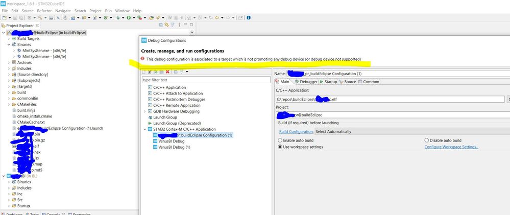

Our project firmware is build using cmake. Cmake is used to create Eclipse project like this
cmake ..\Firmware -G"Eclipse CDT4 - Ninja" -DCMAKE_ECLIPSE_VERSION=4.16
I can import project to CubeIde without proplems and buid it there. Proplem is that CubeIde debugger configuration does seems to accept project as valid project for debuged in stm32.
I have also created bootloader using CubeIde and that I can use for debugging and I have attached Firmware elf to be loaded when BL is debugged. This is workaround to make possible to use CubeIde debugging our firmware.
I attach photo Eclipse error message when configuring debugger
0693W00000BaAcuQAF.jpgHow I should modify our Firmware project so that CubeIde can use it directly to debugging?
