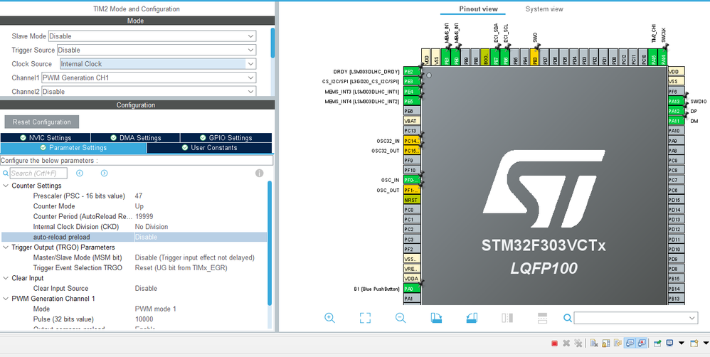

Hi. I have a STM32F3Discovery card, from that i try to control a Blue Robotics Basic ESC and a M100 motor. I set it up using STM32CudeIDE for a 50Hz PWM signal on PA15. The problem is to send a 1500 microseconds initzialization signal. How do i do this?

__HAL_TIM_SET_COMPARE(&htim1, TIM_CHANNEL_1, pulse_width);
The pulse width depends on the timer prescaler and period. You might set the prescaler such that timer clock is 1MHz. Then a 50 Hz period corresponds to a period length of 20000 (µs). Note that everything counts from 0. So you set the upper limit to 20000-1 and the prescaler to e.g. 48-1 if the SysClock is 48 MHz.
hth
KnarfB
MHelg.1

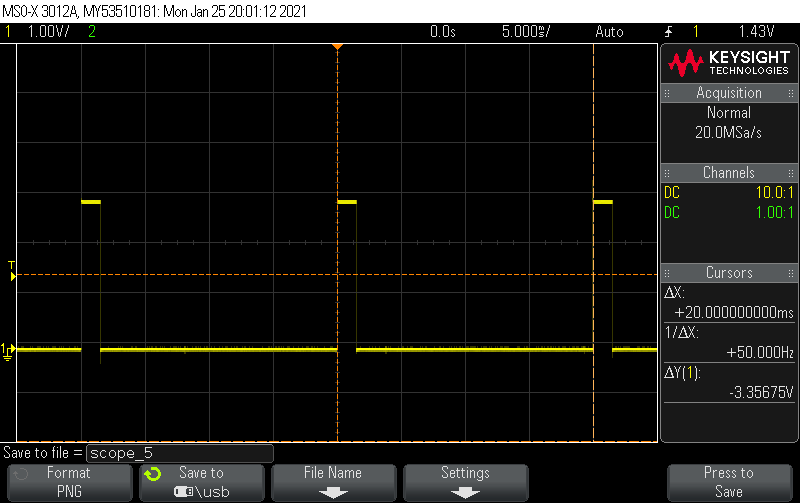

Thank you. I`ve set it up using 48MHz, Prescaler 47, Counter Period 19999 and Pulse 10000. I got a 50 Hz signal with period length 20000 µs.
Below are my code. I get a 1500 µs pulse (Initzialization signal) but i want a delay for 2 seconds and then give a 1700 µs to run the motor. This does not happen?

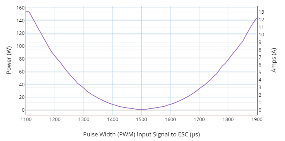

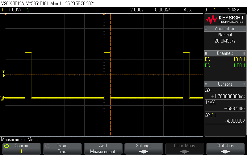

Attached are oscilloscope print and motor diagram if needed.0693W000007CW3YQAW.png0693W000007CW3TQAW.png
Do you delay after the second setting? Should this be in a loop?
Scope isn't showing multiple seconds, diagram the waveform you actually want to see.

Still doesent change after 2 seconds to a 1700 µs pulse. Is it possible that i have reset the timer before sending a new signal?
No, you don't have to reset. The __HAL macro results in a single register write and that's fine.
Your code should work. Are you sure that the last line is reached, i.e. HAL_Delay is working okay (needs SysTick running, not in interrupt).

Verifed the HAL_Delay on my oscilloscope, and now it changes to 1700 µs after 2 seconds!
Fantastic, but my motor wont run. If you guys cant fint anything wrong with my code i suspect the ESC to be defect..
Anyway thanks for your help
2 seconds delay 1700 µs0693W000007CWYMQA4.pngSTM32CubeIDE setup0693W000007CWYCQA4.png

ESC has typically a dead-zone around the neutral value (although your diagram doesn't show one). You could carefully try larger values or put the scope at the ESC output.
