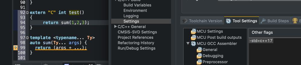

I am using IDE 1.5.0 with the -std=gnu++17 flag set
When trying to use fold expression, the compiler throws an error.

STM32CubeIDE 1.5.0 (1.4.2 is fine too) no issue to me if C++17 usage. According to me proper g++ switch is "-std=c++17" not "-std=gnu++17"

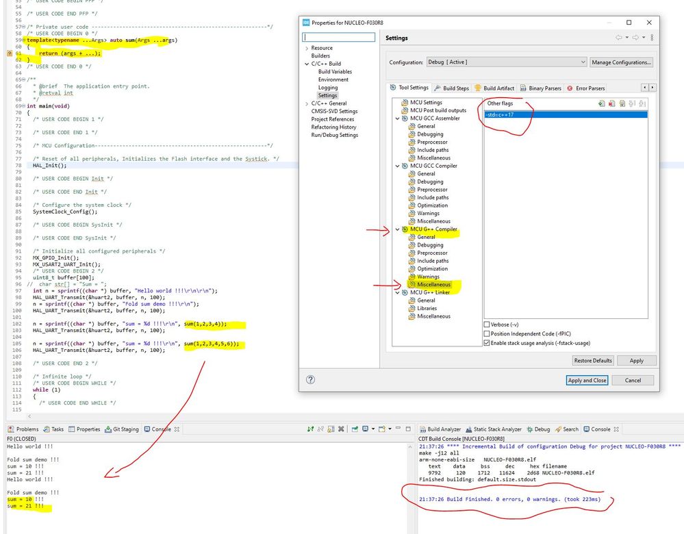

0693W000005C2YOQA0.pngIt doesn't work for me and on -std = c ++ 17
AKlep.1
Correction: works, but IDE emphasizes fold expression. Apparently we should expect further fixes.
Compiler (gcc/g++ here) is one thing, C editor code analysis engine another ...
Maybe CDT is late here (but 2017 post) ? https://www.eclipse.org/community/eclipse_newsletter/2017/april/article3.php
