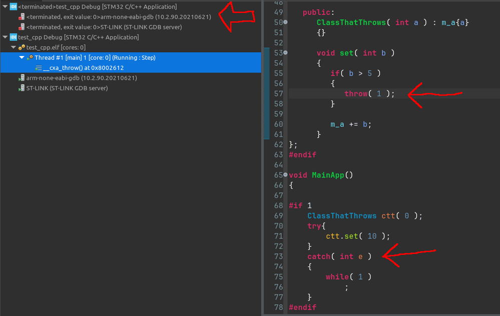

Exceptions allowed, the program abruptly terminates:
The program reaches this point before it terminates:

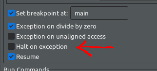

The debugger is set (I guess) no to halt on exceptions:

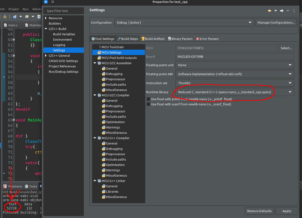

fenardC
Hi
What is working for me, is to select the correct the Runtime Library in the STM32CubeIDE for your project, in my case with v1.18.1, nano_c_standard_cpp

Hi!
Thank you for the advice, it worked!.
I've been thinking that exceptions for embedded systems weren't that bad... until I made them work.
In fact the nano_c_stardad_cpp variant let the exceptions to run as expected, with a high price to pay, though: massive FLASH usage:
No exceptions at all: 6KB
nano_c_reduced_cpp: 12 KB and doesn't work
nano_c_standard_cpp: 52KB (OMG!)
For chips with plenty of memory that can be feasible, but not for small size uC.
Such figures are correct?
