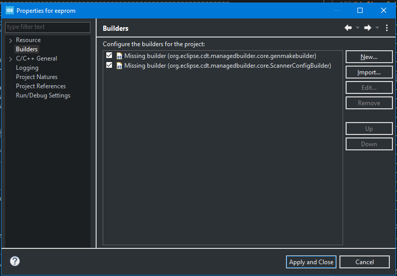

All the existing projects show missing builders.

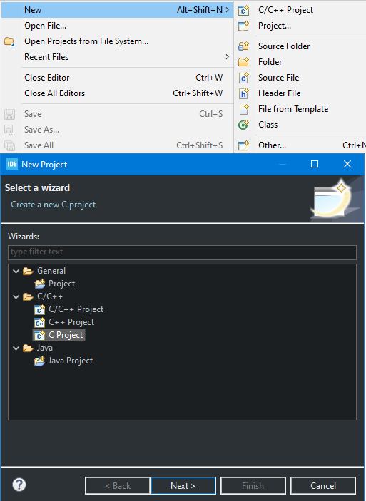

Can't create stm32 project (the option is gone).

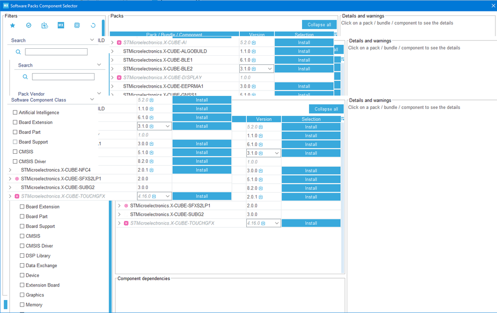

Also the CubeMX software manager appear totally distorted and broken,
