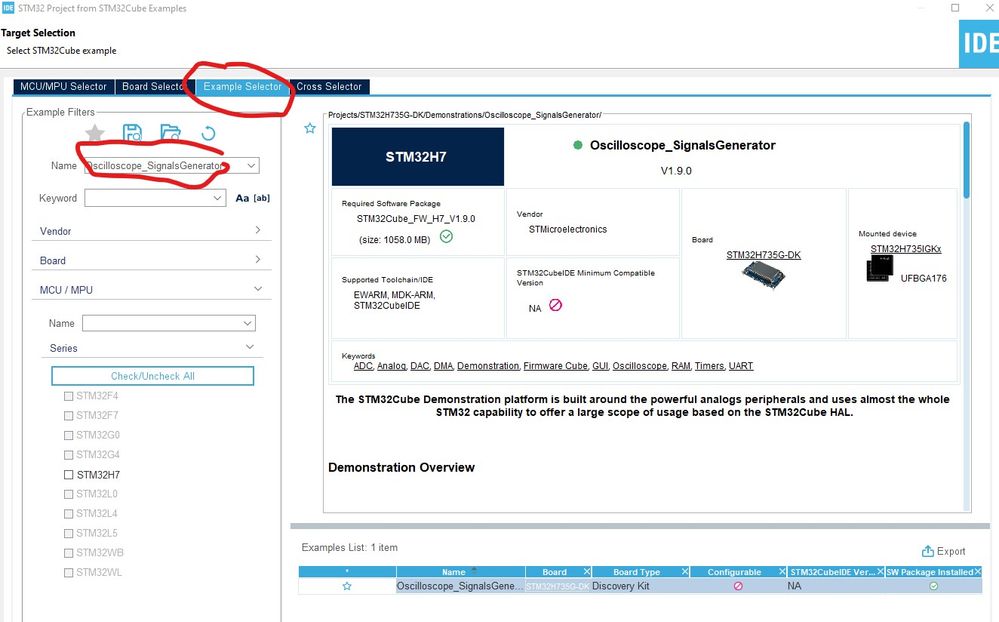

Oscilloscope_SignalsGenerator example Not Loading the Kit. i got the Error like
Error in final launch sequence:
Failed to execute MI command:
load E:\\ST\\en.stm32cubeh7_v1-9-0\\STM32Cube_FW_H7_V1.9.0\\Projects\\STM32H735G-DK\\Demonstrations\\Oscilloscope_SignalsGenerator\\STM32CubeIDE\\Debug\\Oscilloscope_SignalsGenerator-STM32H735G-DK_OoB_V1.0.0.elf
Error message from debugger back end:
Load failed
Load failed
Load failed
Load failed

Just in case could you get a new try relying on File > Import > General > Import STM32Cube example
Let us know if helping or leading to same trouble.

I had some feedback from devs providing the examples that could remove some of the confusion. I copy paste:
Be carful, the demo was made to have:
- EEMBC® CoreMark® benchmark
Running from internal flash and giving 2777 CoreMark® with CPU at 550MHz
- Oscilloscope/Signals Generator:
- Code Execution from external OctoSPI flash
- LCD display from external OctoSPI RAM
- TouchGFX graphical demonstration
This Demo MenuLauncher must be programmed into the board first to allow running sub-demonstrations
The menu MenuLauncher will configure the external OctoSPI memories the will allow user to select one of the sub-demo (EEMBC, Oscilloscope or TouchGFX )
So the Oscilloscope linker and VTOR are correct.
Please have look at the readme.txt at the root STM32H735G-DK\Demonstrations folder
So that could explain issues with linker script, vtor, etc, since the project is supposed to contain a demolauncher!
They however confirmed my suspicion that there is a mix-up of TIM6 and TIM7.
