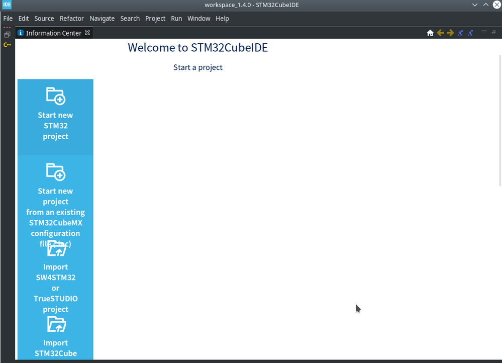

I need help.
Please look at the picture below.
What should I do?

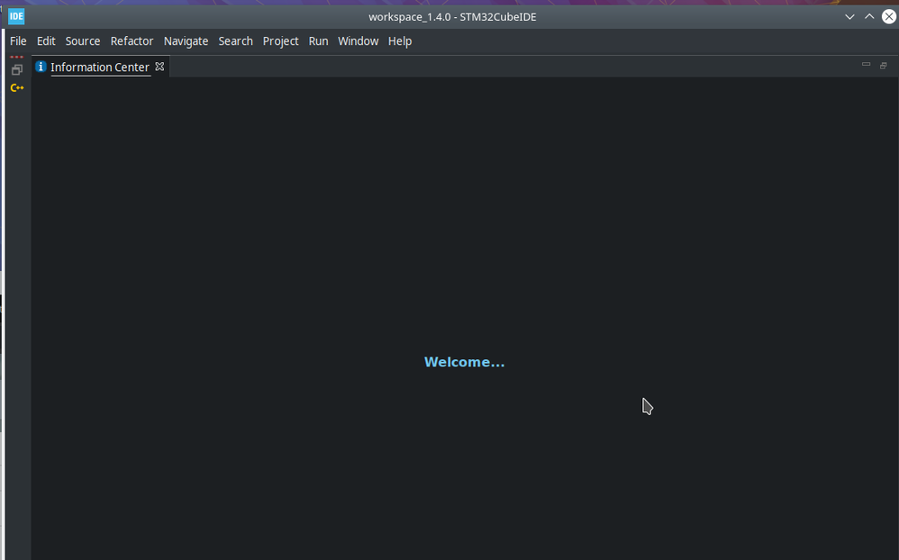

I found the answer.
Please install "webkitgtk" >> version 2 or 3
command
- sudo apt-get update -y
- sudo apt-get install -y libwebkitgtk-3.0-0
- sudo apt-get upgrade -y
Goold LUCK... HAHA!
