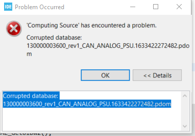

cubeIDE, Corrupted database?
‎2021-10-18 12:52 AM
This happened, i am still able to compile and debug code.
But all the autocomplete (Ctrl+space), funcion linking (ctrl+ left click) and search tools....all nice coding aid features are gone.
what is causing this, is there any way of fixing it without erasing the entire workspace?

‎2021-10-18 6:30 AM
You could try rebuilding the index and refreshing files. Right click project -> Index -> ...
Doesn't appear to be a common error.

‎2021-10-19 6:05 AM
it worked, thanks.
Happened to me 3 or 4 times already... only now annoyed me enough to do something about it
