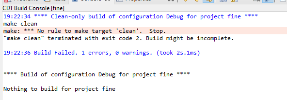

I've just now switched from TrueSTUDIO to CubeIDE 1.7.0, and when I tried to clean the project by selecting Project -> Clean ... from the menu, I got an error message:
19:26:52 **** Clean-only build of configuration Debug for project xx ****
make clean
make: *** No rule to make target 'clean'. Stop.
"make clean" terminated with exit code 2. Build might be incomplete.
19:26:53 Build Failed. 1 errors, 0 warnings. (took 116ms)
Why did CubeIDE not migrate that correctly, and how can I fix this?

Does the project build after that? If yes, ignore the clean error.
Sorry, good question, but the answer is no.
Even if I change my code (e.g., by commenting out a line), Ctrl-B yields
**** Build of configuration Debug for project xx ****
Nothing to build for project xx

@Lars Beiderbecke​ kind of pity ... myself TrueStudio import works like a charm since STM32CubeIDE day0. Still if 1.7.0.
How do you import TrueStudio project ?????
"File > Open Project From File System" or "File > Import > General > Import Atollic TrueStudio" are both way to do. Any other is not suitable.
Works 2 clicks like a charm what's by the way not so surprising moving from an Eclipse based proposal to another.
I've got a try to only "File > Import > General > Existing projects into workspace" such is leading to same behavior you're reporting:
Thinking not tool issue but usage one .... ;)
