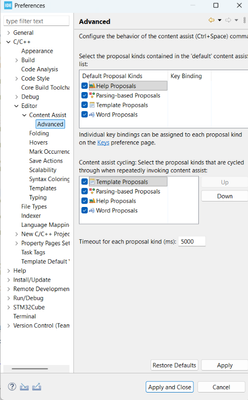

Autocomplete not working on IDE v2.0.0
diktril
Autocomplete is not working on v2.0.0, also didn't work on v1.19.
MacOS 15.5
Macbook Pro 16"
2,3 GHz 8-Core Intel Core i9
Any suggestions?

Hello @diktril
On macOS, Ctrl + Space is NOT handled by STM32CubeIDE — it is intercepted by macOS because it is the default shortcut for “Change Input Source”.
This is why Content Assist does not appear in CubeIDE.
You need to change macOS shortcut:
-   Open System Settings
-  Go to Keyboard → Keyboard Shortcuts
-  Open Input Sources
-  Disable or change the shortcut for: Select the previous input source ; Select the next input source
After disabling it, restart STM32CubeIDE and Ctrl+Space will work normally.
I will be waiting for your feedback.
Thanks.
Mahmoud

Mahmoud Ben Romdhane
Hello @diktril
Thanks.
Mahmoud
diktril
Don't know what caused this setting to change. Working. Thanks.
