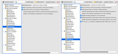

I have been working on a C++ project for the STM32F476G-DISCO, which was originally created in 1.5.0 of the IDE. Given the QoL improvements in the IDE updates, I thought it would be worth updating.
My application has image processing included so I am able to monitor the FPS accordingly. With this in mind, I have noted that upgrading to 1.14.1 (with no project changes required) has yielded me an FPS reduction of about 8 % on average.
It is not a huge reduction, but naturally I am curious as to whether anyone could potentially provide some insight on why this might be happening. As far as I can see, all optimisation settings have been maintained when importing to 1.14.1 - perhaps new flags/commands I am missing?
For reference, the compiler versions per IDE are as follows:
1.5.0: gnu-tools-for-stm32.7-2018-q2-update.macos64_1.5.0.202011040924 (arm-non-eabi) C++ 7.3.1
1.14.1: gnu-tools-for-stm32.11.3.rel1.macos64_1.1.100.202310310803 (arm-none-eabi) C++ 11.3.1
Thanks in advance, and please do not hesitate to query additional information that would assist with this query!

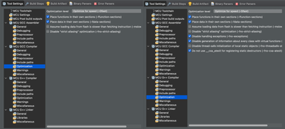

What compiler settings for optimization are in use?
JaredP
1.5.0 optimisation config:
1.14.1 optimisation config:
