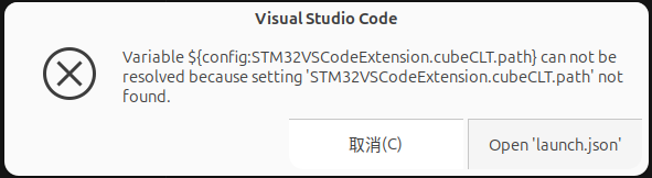

No cli (CLT) tools for debugging on Ubuntu in latest stm32 cube vscode extension
brucegong
Newly installed Ubuntu 25.04
Newly installed VSCode with STM32Cube for Visual Studio Code(preview)
The project generated by STM32CubeMX can be compiled, but cannot be debugged.

more information:
It seems that the preview version of the tool cannot get the permission to open st-link. However, it also does not prompt for sudo privileges.
STMicroelectronics ST-LINK GDB server. Version 7.10.0
Copyright (c) 2025, STMicroelectronics. All rights reserved.
Starting server with the following options:
Persistent Mode : Disabled
Logging Level : 8
Listen Port Number : 61234
Status Refresh Delay : 15s
Verbose Mode : Disabled
SWD Debug : Enabled
InitWhile : Enabled
libusb: error [get_usbfs_fd] libusb couldn't open USB device /dev/bus/usb/001/006, errno=13
libusb: error [get_usbfs_fd] libusb requires write access to USB device nodes
ST-Link enumeration failed
Error in initializing ST-LINK device.
Reason: ST-LINK DLL error.
cube has exited with code 2GNU gdb (GNU Tools for STM32 13.3.rel1.20250523-0900) 14.2.90.20240526-git

brucegong
Sorry guys ,it is my fault.
sudo chmod 0666 /dev/bus/usb/001/006
and debug is OK
