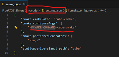

Within VSCODE terminal my ninja build (from MX cmake project) will run just great.   But in the Winwows CLI I get 'cube-cmake '  is not recognised.....
When I add
%USERPROFILE%/.vscode/extensions/stmicroelectronics.stm32cube-ide-build-cmake-1.43.0/resources/cube-cmake/win32 to the PATH, windows says ''cube' command is not available in current context'
I'm looking for some clues to understand the issue a bit better!
Thanks in advance,
Nick

Thanks for the reply @vincent_grenet .  The reason for this question is the following.
I was building in windows CLI.     I run
'cmake --preset Debug'
in  windows CLI andf then
'cd build/Debug'
to generate my makefiles from the cubeMx cmakefile.
I can then run 'ninja clean' or 'ninja' etc to build the project (also in Windows CLI)
Back in VSCode, when I swap projects back to a this project, from another, the extension remakes some of the build files.   If I now run 'ninja' on the CLI, it responds with
'cube-cmake' is not recognized as an internal or external command,"
However, if I run ninja in the VSCODE terminal window it still builds my project.   So I guess its some kind of environment thing, which is geting modified preventing a build outside of VSCode.
If i re-run 'cmake --preset Debug' in CLI it gets fixed.
Hence why I was asking about cube-cmake.
Nick
@Nicholas Parker
May it come from
Such said same as @vincent_grenet I'm unclear about your workflow.
.vscode/settings.json only operates if VS Code in use ... not impacting CLI execution out of VS Code for sure.
Re-created files may come from the fact you're engaging various version of cmake / ninja.
What about ?
cmake --version
cube cmake --version
ninja --version
cube ninja --version
