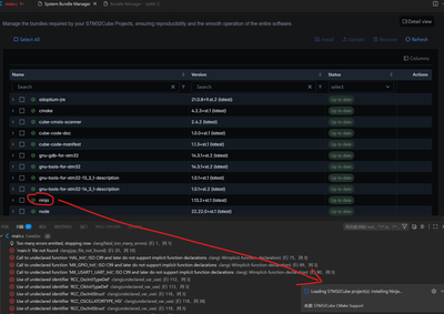

Hi, the extension version is 3.8.0, and it usually takes 5min to load, is that normal? Also, is there any CDN or dedicated server for Chinese users? cuz it's troublesome to download those bundles here. Thx

sometimes it fails
2026-04-24 10:44:10.437 [Info]  Adding STM32Cube CLI path to environment: c:\Users\yihen\.vscode\extensions\stmicroelectronics.stm32cube-ide-core-1.2.1-win32-x64\resources\binaries\win32\x86_64
2026-04-24 10:44:10.559 [Info]  Configuring CUBE_BUNDLE_PATH environment: C:\Users\yihen\AppData\Local\stm32cube\bundles
2026-04-24 10:44:10.560 [Info]  NODE_EXTRA_CA_CERTS is not set
2026-04-24 10:44:10.650 [Info]  CMSIS_PACK_ROOT=C:\Users\yihen\AppData\Local\stm32cube\packs
2026-04-24 10:44:15.379 [Info]  cube wrapper version: 0.10.2
2026-04-24 10:44:16.317 [Info]  Online bundle cache built
2026-04-24 10:51:17.893 [Info]  Installing STM32Cube bundles prerequisites
2026-04-24 10:52:16.145 [Error]  Failed to initialize STM32Cube bundles: Failed to get list of available updates. Command failed with
2026-04-24 10:52:16.150 [Info]  STM32Cube Core activated (485736ms)
2026-04-24 10:52:16.152 [Info]  Syncing CMSIS-Pack metadata for C:\Users\yihen\AppData\Local\stm32cube\packs
2026-04-24 10:52:16.154 [Info]  No need to sync metadata, since recently updated.

Be assured, it is not downloaded every time. However, yes, when registering a bundle in a project, network access may be used to get an updated list of bundles in the local metadata cache.
I see 2 errors:
Likely, the cube bundle list-online command run by the extension at startup failed, while a couple of days ago you said it worked fine. Was there any network change in the meantime?
The screenshot notification.
Do you already have any .settings/bundle.store.json file in your project?
If so does it contain Ninja?
Maybe try to do the same operation from the CLI to ensure no useful error message is being hidden by the UI: cube --cwd <project_path> bundle install ninja --project
