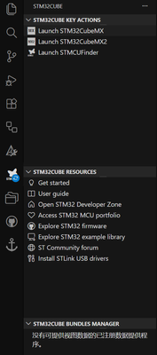

Hi, the extension version is 3.8.0, and it usually takes 5min to load, is that normal? Also, is there any CDN or dedicated server for Chinese users? cuz it's troublesome to download those bundles here. Thx

Seems not a server issue, those 2 commands replied immediately, but the extension still takes long time to load.

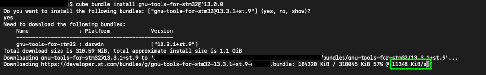

It would be interesting to compare bundle downloads speeds in the 2 configurations (with and without your proxy) by manually installing a toolchain bundle:
cube bundle install gnu-tools-for-stm32@^13.0.0
It can be removed later thanks this command:
cube bundle remove gnu-tools-for-stm32@^13.0.0
Without proxy: 7000 KB/s
With proxy: timeout
I've put *st.com into the proxy whitelist; it shouldn't affect the download speed.
Wouldn't this clearly indicate that your local proxy configuration is somehow blocking traffic? If so, your proxy logs should help identify which flow is being rejected.
Additionally, if your proxy performs SSL inspection, you may need to set the NODE_EXTRA_CA_CERTS variable to configure your proxy's root CA certificate. A simple cube pack sync command will show SSL errors if the handshake fails. If the command works, you can ignore this comment.
