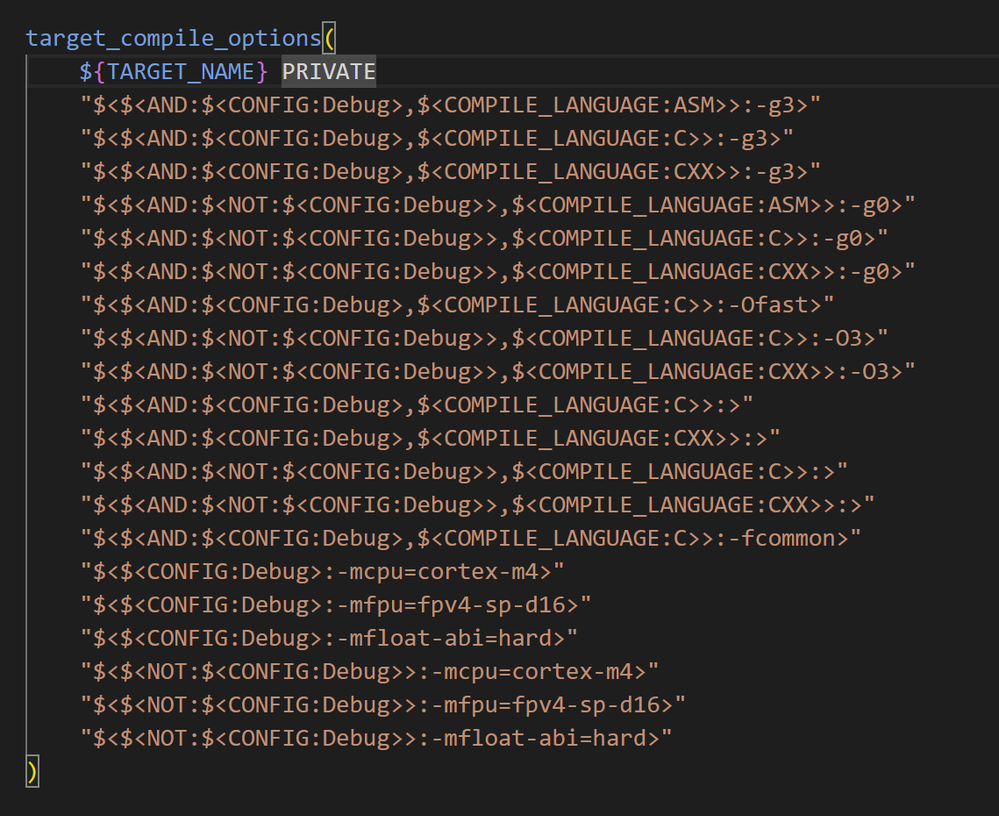

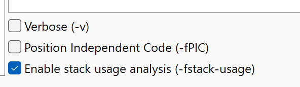

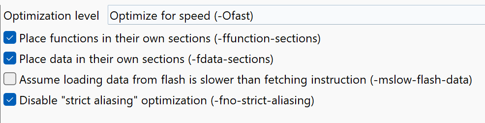

I noticed some descrpancy between the output binary from CubeIDE build and the VS Code build. While investigating this I noticed that there was some missing compiler options in the cmake file. The options missing are -fno-strict-aliasing from GCC compiler optimization settings, -mthumb, -fstack-usage, and -c.0693W00000aJoFDQA0.png0693W00000aJoR4QAK.png
The flags and options in the cmake output files are,

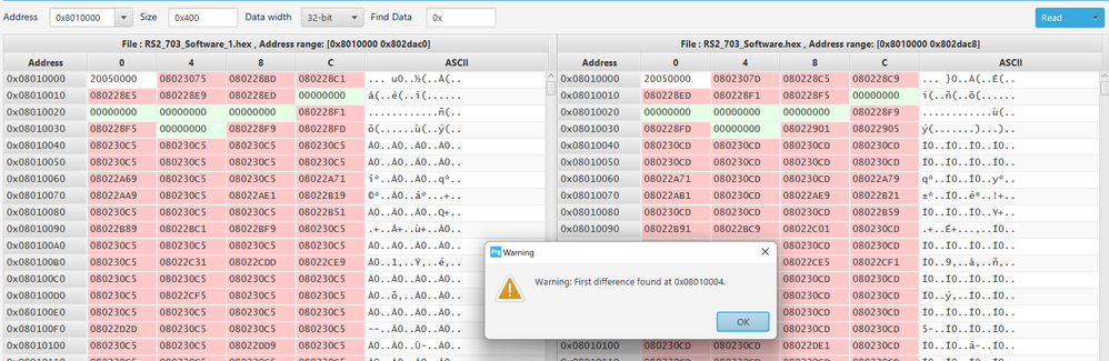

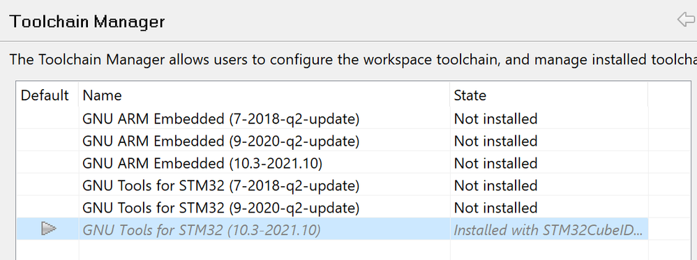

0693W00000aJoT0QAK.png0693W00000aJoTtQAK.pngAfter rectifying the missing complier flags, I still notice that the output binary between VS Code and Cube IDE still do not match. 0693W00000aJocWQAS.pngAt this point, I'm not sure where the discrepancy is coming through. I have check that the same tool chain is being invoked in both scenarios, and have checked GG_COLLECT_OPTIONS for any discrepancies.
Toolchain VS Code: "C:/ST/STM32CubeIDE_1.10.1/STM32CubeIDE/plugins/com.st.stm32cube.ide.mcu.externaltools.gnu-tools-for-stm32.10.3-2021.10.win32_1.0.0.202111181127/tools/bin"
Toolchain CubeIDE:

At identical flags the produced binaries should differ only because of the link order.
CubeIDE's objects.list order is not identical to VS Code's st-project.cmake .
If you manually reorder the latter according for the former you should get the exact same binary.
I did try this a while back confirming the observation, but I haven't retried it recently.
I believe VS Code's importer strictly follows the .cproject order while CubeIDE sorts the source tree in a slightly different way.
