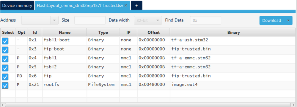

I will have to get the logs next week when I can program a board. Below is my tsv, I don't use the extra partitions (bootfs,vendorfs,userfs) that OpenSTLinux uses.

0693W00000QLRhDQAX.pngThe issue appears to be that there is no "Name" on the bad image. On a good image, the "Name" appears as rootfs.
0693W00000QLRiGQAX.pngI am trying to follow some of the latest stuff on the ST Wiki. Is the PARTUUID possibly causing me issues? I have not used that in the past and unsure of the implications other than I am currently doing nothing with it.
From the ST Wiki - "The partition named "rootfs" has a specific PARTUUID."

@user_ABCD​ ,
As a first test, can you try to make your rootfs partition a System type instead of a Filesystem type ? I do not know if it as an impact on TF-A's reading capability but I just want to be sure before going further.
Regards.
Erwan
@Erwan SZYMANSKI​
I actually had previously tried that and it does not change anything.
The 'System' partition named "bootfs" is marked 'bootable'.
This is a statement from the wiki and it is unclear what actually makes something "bootable". Anyways, System and Filesystem create the same TF-A exception.
