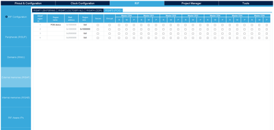

I’ve encountered the same issue. Would you mind showing me how to configure this in CubeMX?
Hello @Steven-LIN ,
If you want to be able to access the PCIE region with the PCIE master and the Cortex-A35: select at least Read/Write for the CID1 (CID of the Cortex A35).
If you have configured the RIF so that CID filtering is enabled on the slave port of the PCIE(RISUP) and the master port of the PCIE(RIMU) is in inheritance mode(default), then you'll have to select also the CID specified for the RISUP.
If you have configured the RIF so that CID filtering is enabled on the slave port of the PCIE(RISUP) and the master port of the PCIE(RIMU) is not in inheritance mode (CIDSEL), then you'll have to select also the CID specified for the RIMU.
Else, if CID filtering is disabled on the PCIE RISUP, then please select CID0 as the RIMU of the PCIE will hold CID0 on the bus.
Regarding secure and privilege rights, I let you decide what's fitting your case. If it's for PCIE in  Linux kernel, I suggest not to select secure.
